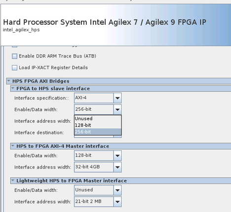

I'm working with Agilex 7 AGM039 device and in platform designer I see that data width of FPGA-to-HPS bridge has only 2 valid options: 128b and 256b, while with Agilex 7 I-series it has 512b option(FPGA-to-HPS Bridge). Also in documentation for Agilex 7 HPS I didn't find any mentions that data width doesn't have 512b option.
So my question is whether it is an undocumented feature or there is something wrong with my Quartus?
Quartus version is 23.4 and Platform Designer 23.4 Build 79.
From our factory team, the Agilex 7 M-series is 128/256 bit.
We will update our documentation on this info.
