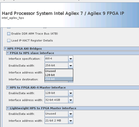

Hello I'm working with Agilex 7 AGM039 device and in platform designer I see that data width of FPGA-to-HPS bridge has only 2 valid options: 128b and 256b, while with Agilex 7 I-series it has 512b o...

From our factory team, the Agilex 7 M-series is 128/256 bit.
We will update our documentation on this info.
