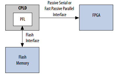

Then probably can set the configuration scheme and mode to passive serial as The PFL IP core allows you to configure the FPGA in passive serial (PS) or fast passive parallel (FPP) scheme. Check this https://www.intel.com/content/www/us/en/docs/programmable/683698/21-1-19-1-0/supported-schemes-and-features.html
