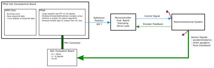

I'm looking for some advice with regards to the digital platform I will use for a graduate school project. I have also posted this question on the Digilent forums, so my apologies if you frequent both. brief project overview The aim of this project is to measure the dynamic response of a structure under artificial and/or operational stimulus, and semi-actively tune a dynamic vibration absorber to minimize said response. My chosen methodology requires computing the FFT of multiple sensor signals, performing a simple search on the processed data, and then executing a decision making algorithm to select which frequency the dynamic vibration absorber is tuned to. The worst-case scenario may require computing the real FFT of 4-6 signals over a running window of 1-2 seconds every 5-10ms, with a 24 bit ADC sampling at 10KHz. This is a bit of a contrived scenario, however useful for establishing an upper limit on the performance requirements. The simplified diagram below illustrates roughly what the process will look like. It would be nice to have the response time from electromechanical system output, A, to input B less than 10ms. my background Degree(s) in mechatronics, some experience with the MSP430, and some experience with the DE1 SoC development board for course work. A few courses in digital design and computer science using C++. chosen hardware… This is where you come in. So far I'm leaning towards an FPGA + ARM development board with the addition of an ADC development board so I can get right to development. I'm leaning towards an FPGA, because I want to learn.... these options look attractive:- de10-stanard (http://www.terasic.com.tw/cgi-bin/page/archive.pl?language=english&no=1081) ( ARM + FPGA )
