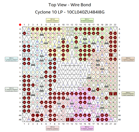

My design uses the Cyclone 10 FPGA - 10CL040ZU484I8G. During fitter stage I get the error:
Error (169057): Can't place I/O pin <clock input name> at pin location T22 -- I/O pin uses weak ...
