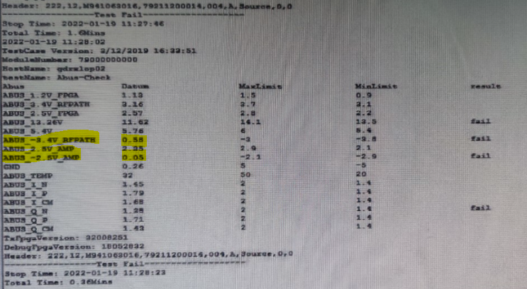

Programmed part U88, 1822-5790 for VXT2
a00001ntcn001001
3720
N/A
ARROW COMPONENTS (M) SDN. BHD.

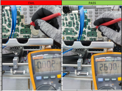

ABUS failure found no voltage at enable +12p5V_EN from FPGA expected 2.6V measured 0V
PO#: 3012705810
Findings:
ABUS failure found no voltage at enable +12p5V_EN from FPGA expected 2.6V measured 0V.
Suspect component U88 FPGA.
