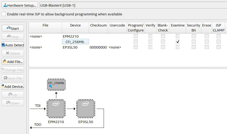

I'd like to examine a CFI device and save data (POF or HEX) by command line like for chain device.
c:\intelFPGA_pro\18.1\qprogrammer\bin64\quartus_pgm -c "USB-BlasterII [USB-1]" -m JTAG -o e;CPLD_U25_dump.pof;EPM2210
or through CDF file.
How it can be done?

Sorry, but it not exactly I need.
I able to execute all operations (erase, program, examine, verify) with a command line or using CDF file.
The problem is to save examined data for CFI device automatically as well.
Thank you.

Sorry for the delay. It should be similar to this > -o e;file.pof;device_name -o ei;file.jic;device_name
Have you tried this one? You can refer in Quartus II Scripting Reference Manual - Intel
Let me know if this works.
Fakhrul
- leonidK
I tried. It works for device in JTAG chain, but doesn't work for CFI device.
