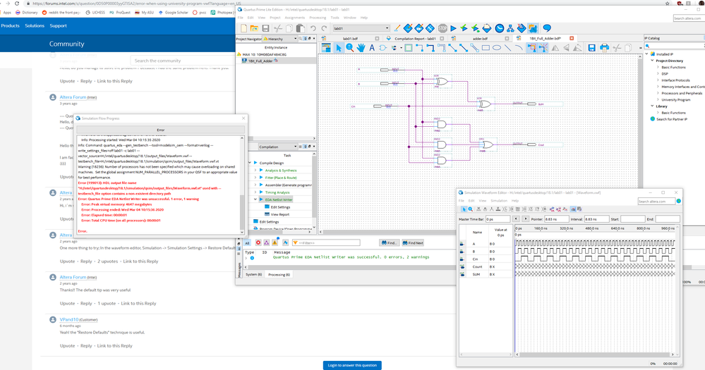

I'm using Quartus 16.1
I want to simulate, but when I press Run functional simulation this error occur
Warning (18236): Number of processors has not been specified which may cause overloading on shared machines. Set the global assignment NUM_PARALLEL_PROCESSORS in your QSF to an appropriate value for best performance.
Error (199014): Vector source file C:/Users/myusername/Desktop/veri/Waveform1.vwf specified with --testbench_vector_input_file option does not exist
Error: Quartus Prime EDA Netlist Writer was unsuccessful. 1 error, 1 warning
Error: Peak virtual memory: 471 megabytes
Error: Processing ended: Fri Dec 30 22:56:30 2016
Error: Elapsed time: 00:00:01
Error: Total CPU time (on all processors): 00:00:01
Error.

  • The simulation settings have a chunk of code that tells it where it saves the data to(the .vwf file is just the viewer for the data). In simulation under simulation settings, after you have loaded the nodes and saved your file, click on restore defaults. If you look at the fourth line in the string of code in this menu as you click on Restore Defaults, you will see it change to the name of your file.
    onerror {exit -code 1}
    vlib work
    vlog -work work prob_c5_4.vo
    vlog -work work prob_c5_4.vwf.vt
    vsim -c -t 1ps -L cyclonev_ver -L altera_ver -L altera_mf_ver -L 220model_ver -L sgate_ver -L altera_lnsim_ver work.prob_c5_4_vlg_vec_tst
    vcd file -direction prob_c5_4.msim.vcd
    vcd add -internal prob_c5_4_vlg_vec_tst/*
    vcd add -internal prob_c5_4_vlg_vec_tst/i1/*
    proc simTimestamp {} {
    echo "Simulation time: $::now ps"
    if { [string equal running [runStatus]] } {
    after 2500 simTimestamp
    run -all
    quit -f
