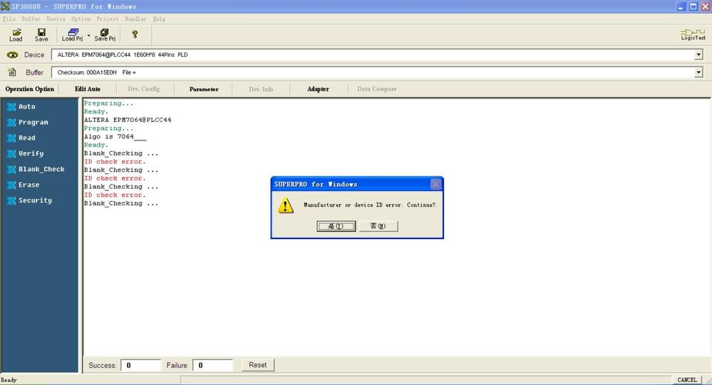

EPM7064LI44-15 is with ID check error, pls check the photos for details. Pls help to suggest how to deal with the problem, thank you.

3 years agoHello,
Can you use Quartus programmer to program the device?
regards,
Farabi
- GloriaChen5203 years ago
Hello Farabi,
Yes, we used uartus programmer to program the device, and it shows the part number is EPM7064S, not EPM7064LI44-15.
Can you sugget how to process it?
Gloria

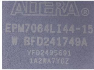

- _AK6DN_3 years ago
What do the markings on the physical device look like? Can you post a photo of it?
A 7064S could be programmed to replace a 7064 exactly in fit/form/function. The JTAG pins can be repurposed.
The 7064 went EOL a long time ago, the 7064S more recently.
Pls check the marking of EPM7064LI44-15, and suggest us how to process next.
