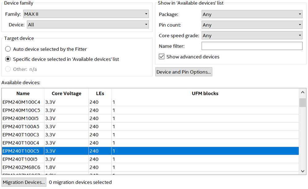

I'm using both Quartus 17.0 and Quartus 13.0. these Quartus support all EPM240 types except EPM240G.
How can I burn the EPM240G (MAX II) when this device doesn’t appear in the library?

Any snapshot possible? You mean when about to select the device in device list? the list number is not there?
Hey Nir,
Can you provide the full device list number?

Can I not select EPM240T100C5 for EPM240GT100C5? they have the same pinout.
You should use the pass I gave and put it .ini in same project path. When you about to create new project, you will later see the device list requested. Select the EPM240G part only
