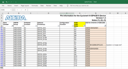

Any layout guide for EP4CE15M9I7N for DDR2 routing?
As it's very small pintch 0.5mm, and we need to consider impedance match, it's not easy to route the trace. Any layout guide line?
In the pin...
AdzimZM_Altera
4 years agoHi Xshen1,
When you're using the DQ X16 configuration, there should be only one DQS within that DQ Group.
