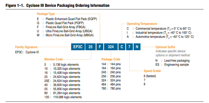

Hi @isagani
Hope you are doing well.
The following handbook will make you understand what is the difference between EP3C5E144C8N and EP3C5E144C7N Cyclone III devices.
Cyclone III Device Handbook Volume 1. Chapter 1. Cyclone III Device Family Overview ( Ref. Page 1-12)
So after looking at the attached image and the handbook you will get that the numbers 7 and 8 in EP3C5E144C8N and EP3C5E144C7N model nos. represents the speed grade of the cyclone III device family.
So speed grade of EP3C5E144C7N is higher than EP3C5E144C8N.
Hence EP3C5E144C7N can replace EP3C5E144C8N as both are having the same package types but there will be an increase in speed grade.
Hope this will resolve your issue.

Hi @isagani

Hi Shivam,
Thank your for the quick response. Can you help me on the speed grade 7 and 8 values?
