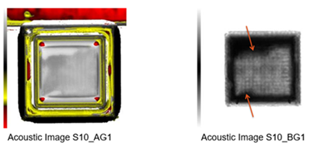

Intel bought Altera. Based on CSAM testing what would be the tolerance for "Voids" on these devices? If Void is not within specs, what effective would it have on the device's functions?

The amount of void should not change over time.
This is ATK’s control for void: Reject - If void > 10% of die size.

After further checking with our Quality team, sorry to tell you that we cannot judge by just the CSAM images below whether it will pass/fail “voids” criteria as there are many factors involved that we are not aware of regarding this part to make any judgement.

After reviewing the info provided "Voids" are present on these type of devices but back to my original question, How do you know how much "void" is consider pass or fail? Can the amount of "Void" change over time? If so, what affect will it affect the device?

I still don't see the "answer" to what is the acceptable "void" for this device?
In percentage or what? After you've reviewed the CSAM results, would this be a
"PASS" by Intel? If it "FAIL", what would cause it? and Would it result in any "Electrical" functions to "FAIL".
