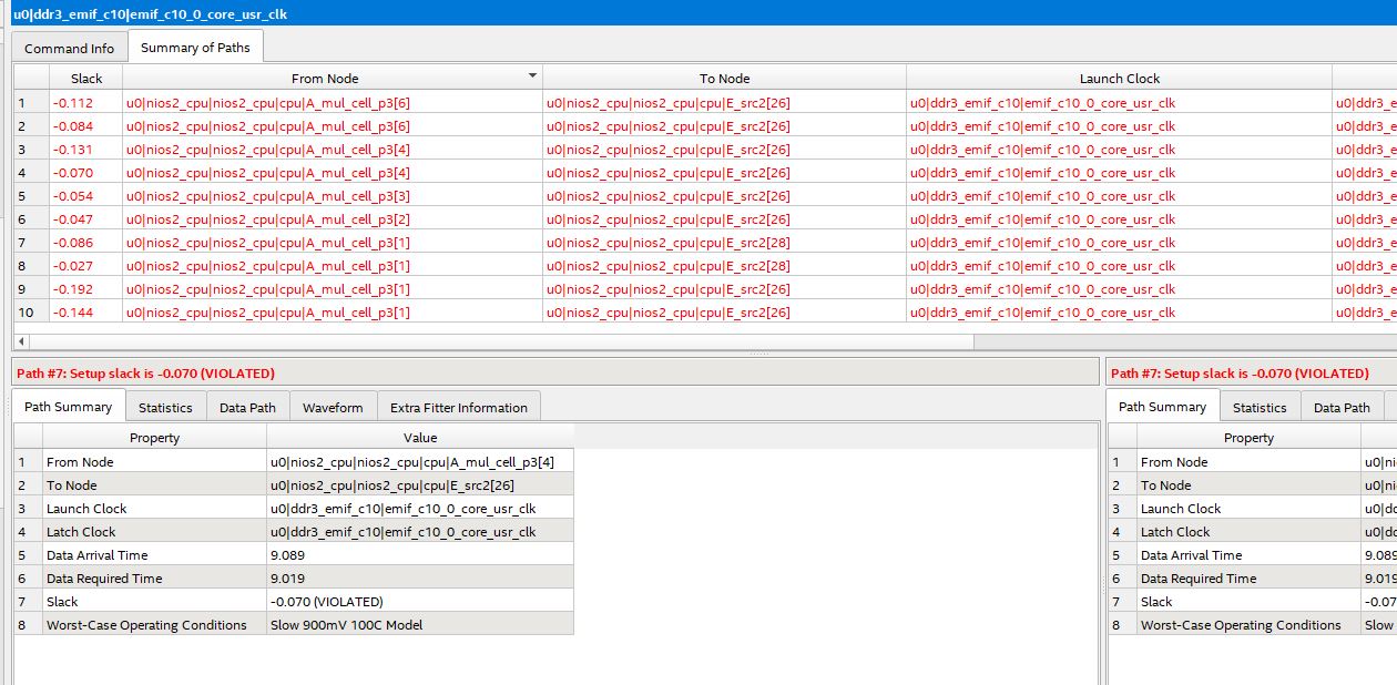

If i use the 800Mhz clock , How can i clock my logic and NIOS with less then quarter of 800Mhz (less of 200Mhz)- this in order to meet timing and relax paths seen in attached picture-1?
i Can use the PLL option to a lower frequencies but i understood that its not recommended as this will not be phase aligned to the emif_usr_clk - as written in the EMIF handbook...

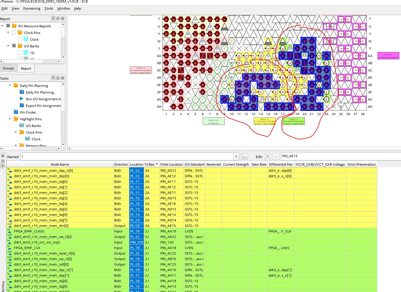

3. I let the fitter freely constrain DDR3 pin allocation to 2 banks of 1.5V , Please see attached picture-2. is this allocation OK ?
Or is just It better to copy the same pins like on the eval board to be on the safe side?
