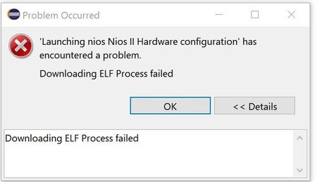

4 years agoEclipse: Downloading ELF process failed?
This is for MAX10 (10M08), nios2, Quartus Lite v20.1.1 (Free version).
I have Quartus Lite 21.1 and eclipse but I had to install Quartus Lite 20.1 because I needed the sdram ip core which is not ...

4 years agoHi,
Please you can refer below for workaround:
https://www.intel.com/content/www/us/en/support/programmable/articles/000078544.html
Also, you can check on this manual for example design instead:
Is the Nios ii processor Reset vector memory properly set? I noticed you configure it to sdram.s1.
Can check on reset and nreset ports as well, may be some connections missing there.
