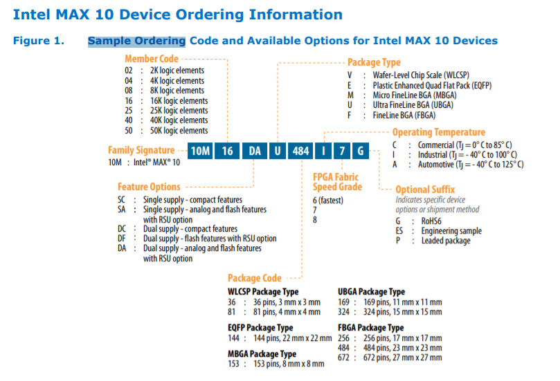

Yes they are the the same generally the same. The OPN with suffix VB indicates that it's a custom OPN. Please refer to below figure:
