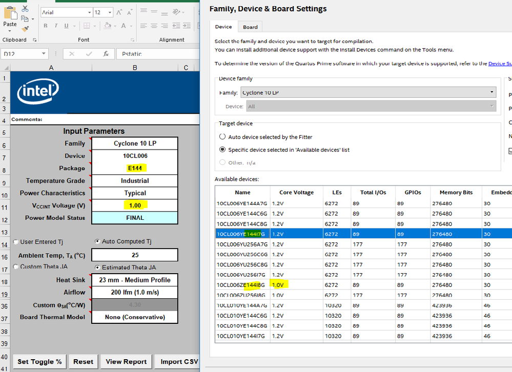

    Hi @MS​
    You will be able to select the VCCINT voltage in the EPE depending on the Device/Package/Temperature Grade you select.
    A quick tips: Use the Quartus device setting as reference to know which device support 1.0V and 1.2V.
    Below screenshot is an example: 10CL006 E144 Industrial that has part number using 1.0V and 1.2V
    I hope this answers your question.
