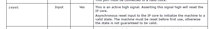

I have generated a remote update IP for Cyclone 10 GX with Flash combination MT25QU01G with Quartus Prime Pro 20.4 tool.
If reset signal is sent to remote update IP, I am observing some strange behavior. It reconfigures some times. If I give reset signal 5 times, One time it reconfigures.
As per document ug_altremote-683695-666531. It says that Asynchronous reset input to the IP core to initialize the machine to a valid state.
Why it randomly reconfigures.

      reset input isn't the intended input to trigger a reconfiguration, it's reconfig input. All remote update IP ports need to meet timing constraints, as any FPGA IP. Reset e.g. is an asynchronous input that need to be released synchronous to clk, otherwise arbitrary erratic behaviour may be observed. Nothing specific to remote update.
      If you e.g. consider to trigger reconfig with a push button, the signal should be debounced and synchronized to clk.

    Conducted some experiments with reset signal pulse width. Though the document say it is asynchronous reset signal. Earlier I had provided reset signal pulse width of 16.67 ns. ( During that time i observed random reconfiguration). I increased the reset signal pulse width to more than 100 ns. Later observed, it reconfigures for every reset signal. I have used 10MHz clock for Remote update IP.
    Is there any minimum requirement of reset signal pulse width?
    or
    Any dependency between Remote update IP clock and reset signal?
