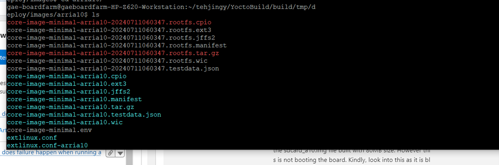

  • tehjingy_Altera's avatar
    tehjingy_Altera
    Hi
    After I run the Yocto build for for the langdale branch the rootfs package is in the path below:
    What is the full command that you used to created the sd card image?
    Are all the required files in the folder for creation and is it the same as the command in the how-to?
    tehjingy_Altera
    Hi
    Sorry for the late reply.
    Got some problem with my laptop recently.
    I just notice I did not attached my screenshot in my previous comment and have attached it.
    For the sdcard creation you will need to use the "core-image-minimal-arria10.rootfs.tar.gz".
