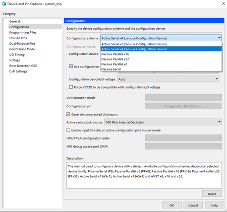

Hi , thank you for your answer,
I want to describe my question in detail once.
My configuration method is to choose Active Serial Mode.
And when I try to compare the programming files with different options.
I found that no matter how I choose Device and Pin options(Configuration scheme) it doesn't affect the content.
As shown in the picture below,Thank you
