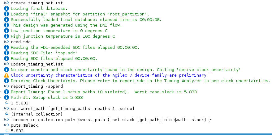

    I try to run the script without problem check screenshot:
    I try to run each command separately without problem check screenshot:
    I think make sure that each previous command can be executed successfully from your side.
