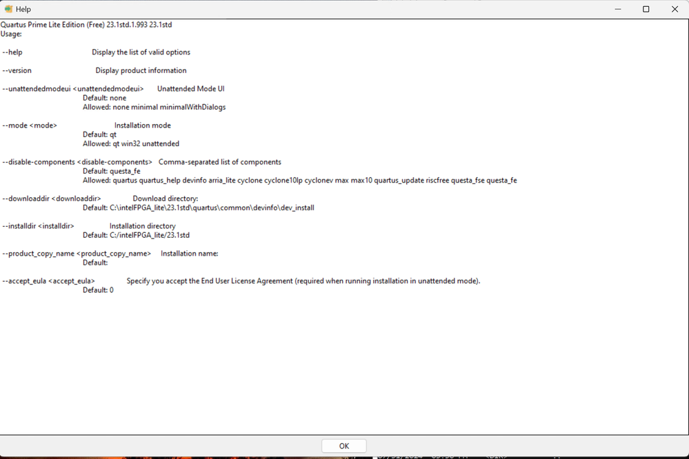

  • FSUCOETech's avatar
    FSUCOETech
    Thanks for the information. It lead me into a good direction. I was able to discover the dev_install.exe has somewhat of a command line option that can me viewed with the --help option.
    However, it does not appear to have the option to select and install the .qdz files.
    My goal is to add Cyclone V to the device family unattended on many of out lab workstations.
    This does not work.
    dev_install.exe --unattendedmodeui none --mode unattended --downloaddir c:\intelFPGA_lite\23.1std\quartus\common\devinfo\dev_install --accept_eula 1
  • FvM's avatar
    FvM
    check quartus_sh -qinstall feature.
