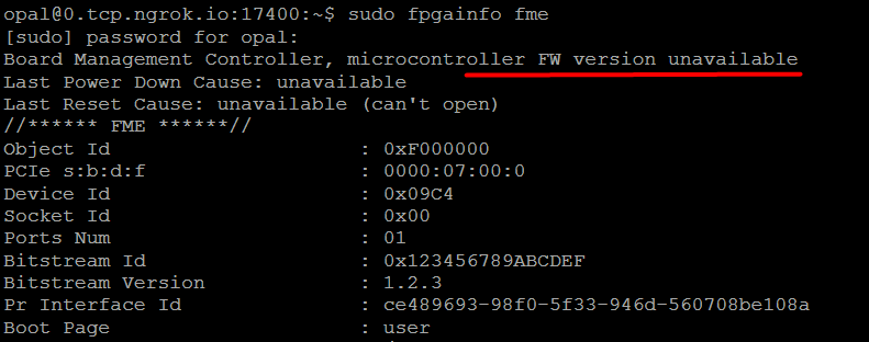

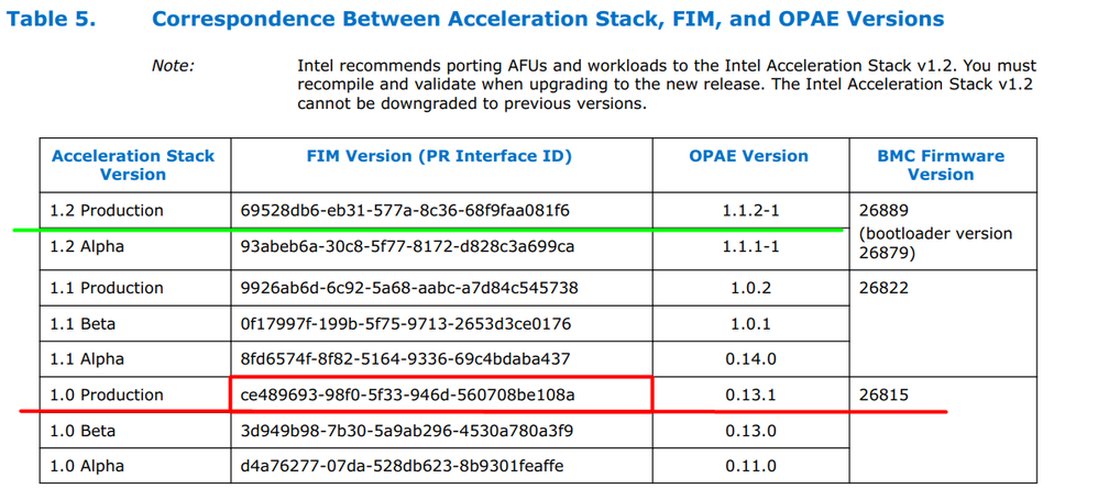

    The problem was that the firmware seems was for 1.0 which would cause some mismatch[ see screenshot from devs]
    So we would wish to upgrade it to compatible with 1.2.1

    our dev requests documentation for A10SA4
    due to some reason they can only flash 1.2 firmware but not 1.2.1
