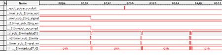

Hi, Im using CycloneVsoc link lwh2f(32bit) ---> Avalon mm pipeline bridge(32bit) -----> MyIP core(8bit) the following is the signal tap result: When I ran alt_write_byte for one time in the ...

2 years agoAnd about the mult write problem, Ive created a new stp, but the problem still exist.
Have you ever meat this knid of wield problem before?
