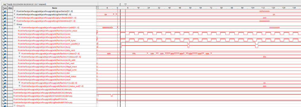

erase and single byte write work fine
however the page write of either 4 or 256 bytes both appear to fail / not do what the user guide says it should

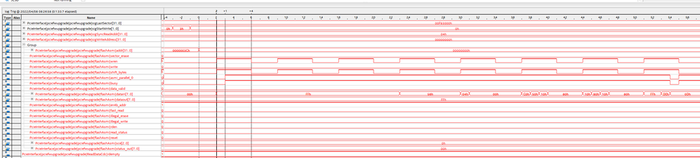

having tapped the IP core signals directly, i am bursting in 4 bytes at a time using the shift_en signal and wren as can be seen in the picture, the busy strobe goes high 1 clock cycle after the first write cycle, not at the end of the burst when the write strobe is applied

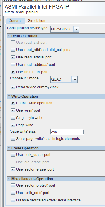

core is set up for the flash chip

It looks like no issue with the IP and setup as you are able to work with single byte writing using the IP. May i know how do you do 256 byte writing?
