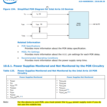

Arria10 POR trip level
Hi there We use 4 pcs 10AX057 in one board, one chip met AS configuration failure occasionally when powered up. Now I doubt the power up sequence maybe out of spec. (1)Would like to ask what i...
  • YuanLi_S_Intel's avatar
    4 years ago
    (1)Would like to ask what is the POR trip voltage levels for all the powers that monitered by POR circuit? Is it 90% of nominal voltage?
    YES.
