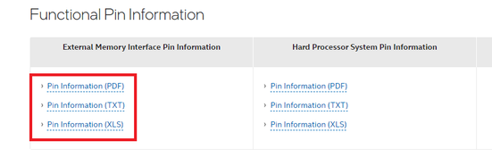

    The better option is to refer to Functional Pin Information document that can be downloaded from the Pin-Out Files website.
    Link: https://www.intel.com/content/www/us/en/support/programmable/support-resources/devices/lit-dp.html#tab-blade-1-2
    In that document, you can find the DDR4 Scheme 1 to 6 and other memory protocol as well.
    It's showing the pin placement for the Address and Command signal. You can refer to this document when fitting the pin placement.
