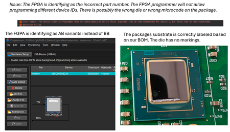

3 hours agoAgilex 7 - Incorrect Device ID in Programmer
I have an device with the substrate marked as a A5EC065BB23AE6S which matched the PN ordered. But in the programmer, the device is reporting as a A5EC065AB23AE6S which has the VID option. VID means...
FvM
1 hour agoHi,
simple explanation. Both devices have same JTAG idcode and can't be distinguished by programmer during Identification.
Both are Agilex 5 rather than Agilex 7 b.t.w.
