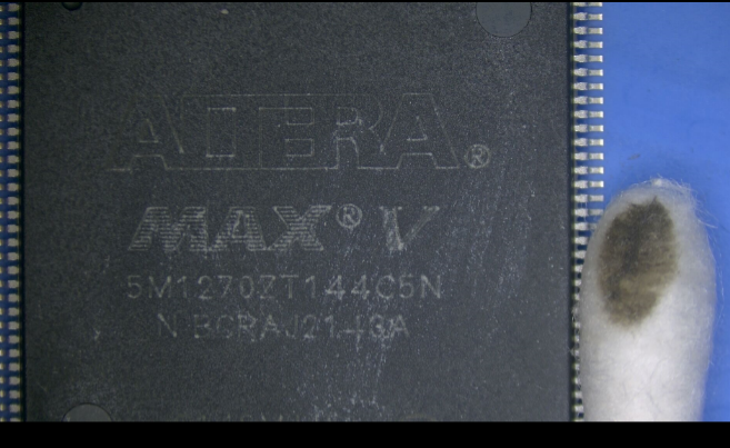

Dear Support,
Please help to check and advise if the marking is just normal after acetone test performed.
Please refer to photo for reference.

    Hi Isagani,
    From the info I got, EMC is epoxy mold compound.
    Aqid Ayman

    Hi Aqid,
    Please help to clarify what is EMC dust?
  • AqidAyman_Altera's avatar
    AqidAyman_Altera
    Hi Isagani,
    Thank you for your patience.
    From what I got, the situation you face are completely normal as when you performed the Acetone test, marking wall can be collapsed and EMC dust is removed. We need EMC dust to see the character more clear in laser marked spot.
    I hope this helps.

  • isagani's avatar
    isagani
    Yes, Please confirm if this is just normal?
    AqidAyman_Altera
    Hi Isagani,
    Did you mean the marking on the packaging is fading after you done the acetone test?
