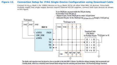

Hello, I am using dual supply device with ADC (10M50DAF484I7G). In my design I initially connected ADC_VREF pin to 2.5V and VCCIO1A/VCCIO1B (so also JTAG connector) to 3.3V. I'm not sure if this is ...

If you do not enable the ADC feature, you may connect VCCIO1A and VCCIO1B pins to different voltage levels, provided that the VREF pin is not used. If the VREF pin is used, you must connect the VCCIO1A and VCCIO1B pins to the same voltage level.
If you enable the ADC feature, connect VCCIO1A and VCCIO1B to 2.5V.
This is what I got from Pin Connection Guidelines for Max 10 (Dual Supply).
It checks all your recommended solutions.

2 years ago@AqidAyman_Intel , thank you for claification and support - this dispels all doubts.
