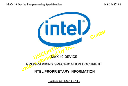

Hi Altera Teams, We are a third-party programmer manufacturer. I am currently supporting the programming of the 10M50DDF256C8G IC. The cover of the programming file I refer to is as shown below. ...

Which ID you are referring to? is is silicon ID or JTAG ID?
Back to your question, basically this document is applicable regardless of any MAX 10 part number. The only thing you need to make sure is when you generate the bitstream, make sure the JTAG ID is matching with the physical device JTAG ID.

I'm referring to JTAG Part Number IDs.Is it possible that the ID of 10M50DD is special?
- stev1222 years ago
Hi Fakhrul.
If it is determined that the programming process can be shared, I would like to ask another question.
Can Program_Done_Bit_Address and ICB_PROGRAM_SUCCESS_Bit_Address also directly refer to the settings of 10M50 in the programming file?
