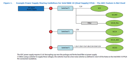

I don't see power up sequence in documents.
Is there any special power up sequence required?

Hi XShen1,
according to the following document: Intel® MAX® 10 Power Management User Guide (https://www.intel.com/content/dam/www/programmable/us/en/pdfs/literature/hb/max-10/ug_m10_pwr.pdfThe Intel MAX 10 device supports any power-up or power-down sequence to simplify system-level design.
Martin
MBenca
5 years agoHi XShen1,
