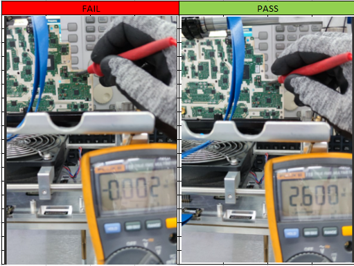

We would like to send for FA analysis support for 1 pcs. The failure was detected by the production and confirmed by the CM.
The details are as below:
Findings:

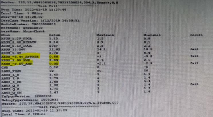

ABUS failure found no voltage at enable +12p5V_EN from FPGA expected 2.6V measured 0V.
Suspect component U88 FPGA.
PART DESCRIPTION
