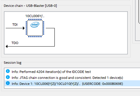

Suddenly, my USB Blaster stopped working. I can no longer transfer the schematic/VHDL to the FPGA. I tried using JTAG Tag Debugger and noticed that the detected device is an altera 10CL, but in rea...

Just would like to check, are you using our Cyclone IV Development kit? Or a custom board?
If you are using our development kit, can you change the USB Blaster to TCK 6MHz and all the switches to default position?
