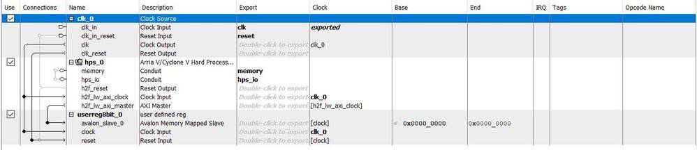

​​Hi, I just build a qsys system as shown below
where I just wana write and read data to a simple 8 bit register which I wrote and instantiated in qsys as usererg8bit. Here is the verilog HDL code for that
