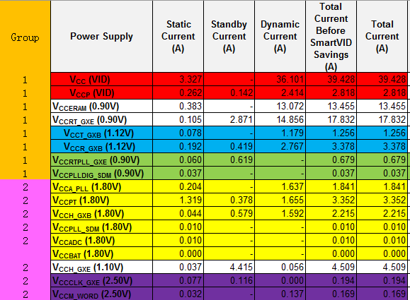

ug-s10-pwr文件中描述For Intel Stratix 10 GX and SX devices, these power rails can be combined and shared using the same voltage regulator as the Group 2 power rail VCCPT if all their voltages are 1.8V. S10 MX的芯片中 Grop2 1.8V应该也可以合并吧?那么Group1中的1.12V和0.9V是否可以合
是否可以按照颜色合并电源输出给FPGA?

    你是说,voltage一样的可以用同一个voltage regulator?如果是的话,是可行的。​
