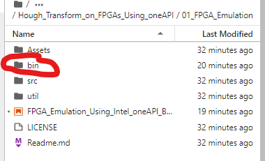

    I have been stuck on this for more than a week now but I had to inform you that the conversation that you linked me to, I tried that even included the ! mkdir bin statement which was used to solve the other users problem. unfortunately that did not solve mine, since i already had a directory named bin within the testdir directory.

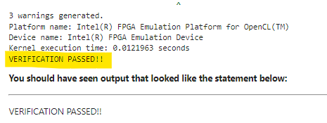

  • Hi @Ratan,
    Noted on the stage that you are still stucked.
    I have pulled the similar hough example mention, and have made the necessary changes line #9, #72 and #76.
    Attached are the zip files that contain hough_transform.cpp that I have changed from my end which is successfully compiled and run emulation.
    Would suggest perhaps to compare with your .cpp files to see if any differences.
    Once .cpp files are made, please go ahead to create a bin directory as below:
    With that you would be able to run the emulation and get the following result as below:
    Note: you can ignore the warning for now as the example code might have some outdated code.
    Best Wishes
    BB
