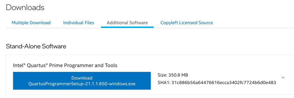

    System Console is included in the separate Programmer download and installation (along with Signal Tap as well).

    Would you be able to share a download link? I can't seem to be able to find it

    Thank you @sstrell. I had been looking for a few days, and never found this.

    Yeah, the web site is tricky sometimes. To get there: Products (at top of page) -> Intel Quartus Prime Design Software -> Downloads.
