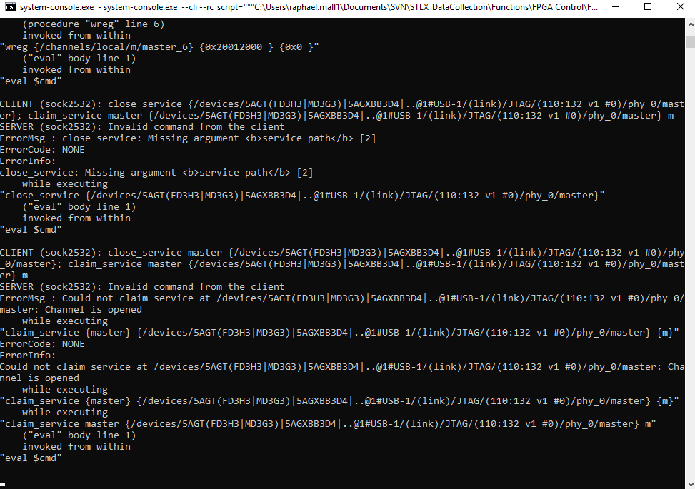

I am trying to close_service & claim_service (to handle disconnected devices).
Unfortunately I am unable to make it work.
  1. How can I close_service pathA, then claim_service pathA ?
  2. Or, alternatively close all service paths, to keep the service console, but start fresh?
close_service master {%s}; claim_service master {%s} m
Response:
CLIENT (sock2532): close_service master {/devices/5AGT(FD3H3|MD3G3)|5AGXBB3D4|..@1#USB-1/(link)/JTAG/(110:132 v1 #0)/phy_0/master}; claim_service master {/devices/5AGT(FD3H3|MD3G3)|5AGXBB3D4|..@1#USB-1/(link)/JTAG/(110:132 v1 #0)/phy_0/master} m
SERVER (sock2532): Invalid command from the client
ErrorMsg : Could not claim service at /devices/5AGT(FD3H3|MD3G3)|5AGXBB3D4|..@1#USB-1/(link)/JTAG/(110:132 v1 #0)/phy_0/master: Channel is opened
    while executing
"claim_service {master} {/devices/5AGT(FD3H3|MD3G3)|5AGXBB3D4|..@1#USB-1/(link)/JTAG/(110:132 v1 #0)/phy_0/master} {m}"
ErrorCode: NONE
ErrorInfo:
    while executing
    while executing
"claim_service master {/devices/5AGT(FD3H3|MD3G3)|5AGXBB3D4|..@1#USB-1/(link)/JTAG/(110:132 v1 #0)/phy_0/master} m"
    ("eval" body line 1)
