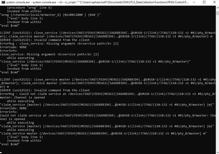

I am trying to close_service & claim_service (to handle disconnected devices).
Unfortunately I am unable to make it work.
How can I close_service pathA, then claim_service pathA ?

Now, to be able to re-claim an existing path, I first need to be able to check if it is closed. However, this command returns 0 regardless of the status (open or closed).
is_service_open master {/devices/5AGT(FD3H3|MD3G3)|5AGXBB3D4|..@1#USB-1/(link)/JTAG/(110:132 v1 #0)/phy_0/master}
Which then errors on the next command to claim it
claim_service master {/devices/5AGT(FD3H3|MD3G3)|5AGXBB3D4|..@1#USB-1/(link)/JTAG/(110:132 v1 #0)/phy_0/master} m CLIENT (sock2256): claim_service master {/devices/5AGT(FD3H3|MD3G3)|5AGXBB3D4|..@1#USB-1/(link)/JTAG/(110:132 v1 #0)/phy_0/master} m SERVER (sock2256): Invalid command from the client ErrorMsg : Could not claim service at /devices/5AGT(FD3H3|MD3G3)|5AGXBB3D4|..@1#USB-1/(link)/JTAG/(110:132 v1 #0)/phy_0/master: Channel is opened
Is it possible "close_service master" does not really close it?

After close_service, you have to get_service again in order to claim_service. claim_service can't be done straight away after closing service.
