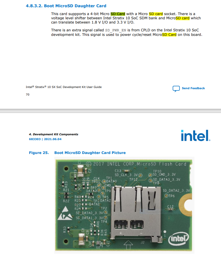

I am using the Intel Stratix10 SX H tile Developement Kit. With the development kit, Boot MicroSD Daughter Card was also there. This daughter card can be connected instead of "QSPI Flash Card" which will be connected to the SDM bank of Stratix 10.
My doubt is like we can flash the jic file to the QSPI Flash connected to the SDM Bank, but inorder to flash the Boot MicroSD Daughter Card what procedure we have to follow.
For the QSPI we use the programming fle generator to generate the jic file by selecting the QSPI Flash part number, but for the "Boot MicroSD Daughter Card" how we will create the jic file.
