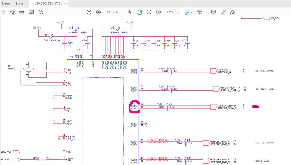

Does anyone know the clock frequency of output 2 of the SI5341 on the Stratix10 SX Evaluation Board? It is on page 34 of the attached schematic.

Also, can you confirm the voltage standard for the output differential pair in question?
Is it LVDS like the other differential output pairs are labeled?
- Vhe
Differential LVPECL
- Farabi_Altera
Si5431 can generate multiple clock standard, but currently it is programmed to generate LVPECL. Register value as in page 23 of this document, link : https://www.skyworksinc.com/-/media/Skyworks/SL/documents/public/reference-manuals/Si5341-40-D-RM.pdf
The frequency can be set using BTS (Board Test System), link : https://www.intel.com/content/www/us/en/docs/programmable/683303/current/the-clock-control.html (Chapter 5.3.10).
