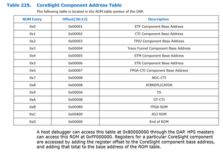

Hi all, I have been looking for the base address of the Stratix 10 HPS ETM for a couple of days already and cannot find it. As you can see bellow, at the Stratix 10 HPS TRM we can find the CoreSigh...

Hi Eduardo
The Embedded Trace Macrocell Address Registers are not listed for users to read/write.
From the information I got is that they are strictly for tool usage.
The debugger tool will access to those registers through their internal ROM table and read/write accordingly.
We do not need to read/write to the registers.
