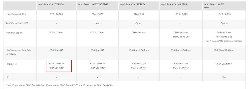

Stratix 10 GX是否支持PCIe4.0?
官网上有资料说S10 GX支持PCIe4.0,但是在quartus里面没有找到相应的PCIe4.0的IP

Hello Sir,
As I know, only Stratix 10 DX device support the PCIe Gen4. May I know where you get the screenshot?
I can't see this table in Intel FPGA PCIe webpage - https://www.intel.com/content/www/us/en/programmable/products/intellectual-property/ip/interface-protocols/m-pci-express-protocol.html
- BoonT_Intel
I found the table from this link - https://www.intel.com/content/www/us/en/products/programmable/fpga/stratix-10.html
By right, only Stratix 10 DX supporting Gen4. Let me clarify and get back to you later.
- BoonT_Intel
It is confirmed that only Arria 10 DX device support PCIe Gen4. The table is a mistake and will be correct soon.
- DZhu1
Correct it.stratix 10 DX,right?
- BoonT_Intel
I am so sorry, yes it is Stratix not Arria.
So, only Stratix 10 DX support Gen4.
- DZhu1
understand.Many thanks!
