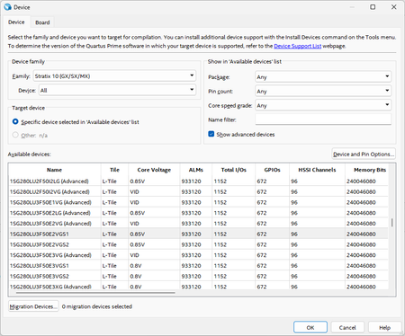

Hi all, I downloaded the design example file below from Intel design store. "Stratix 10 - 1G/2.5G Ethernet Design Example" I'm currently working with Stratix 10 Tx signal integrity Dev Kit. After...

If you are using the TX dev kit, please do ensure the OPN number that you use has the number 1ST value. According the picture that you shared, you are using the wrong OPN number which are not matching with your dev kit. You need ensure that your OPN number matching with your dev kit.

3 years agoHi Zi Ying,
First of all, thank you for your reply.
The OPN is ordering part number, isn't it?
Yes. that's why I left this. Although I downloaded this example file from Intel design store with filtered "Stratix 10 Tx Dev Kit", the specified part numbers in Quartus Prime Pro didn't include any devices starting with TX.
That's my question.
