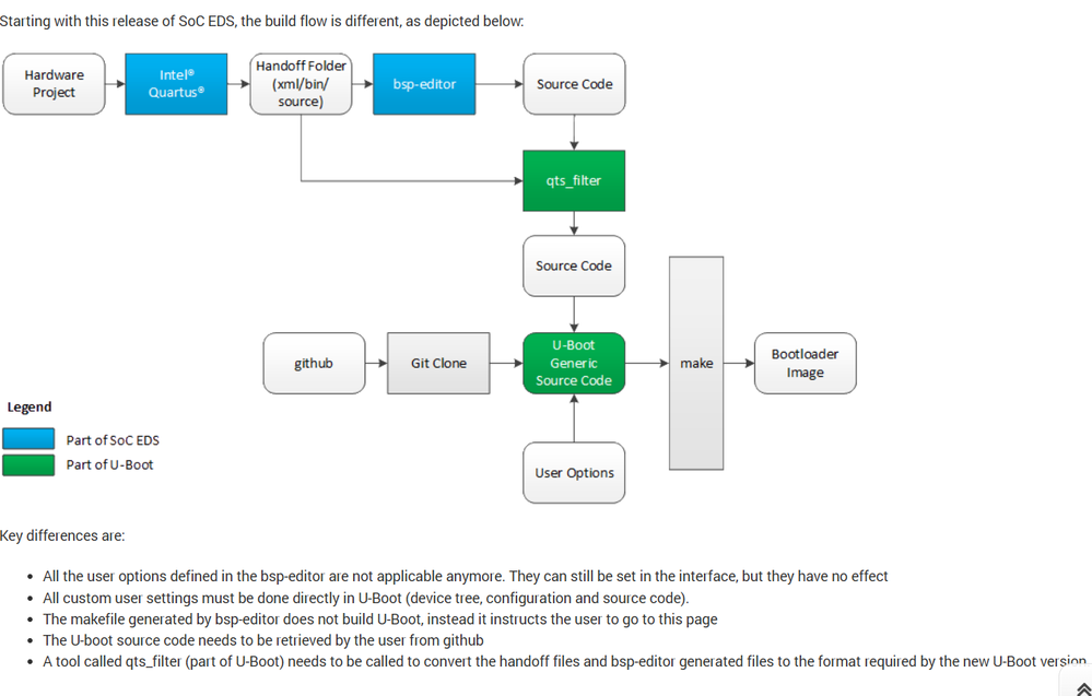

Also, we recommend that you use the latest flow to create the Bootloader or Cyclone V SoC which does not use bsp-editor:
https://www.rocketboards.org/foswiki/Documentation/CycloneVSoCGSRD
- CAlex
Contributor
Sorry if I'm wrong but according to the guide I still need the bsp-editor to get the code if I'm working on the cyclone V ,right?
reguards.
- EBERLAZARE_I_Intel
For the latest version you do no need it. It will use the "cv_bsp_generator.py" script to take the sources from the handoff folder instead of the bsp-editor.
