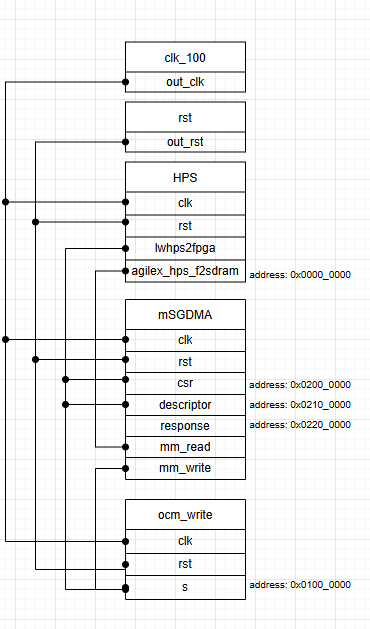

This is what have implemented so far in Quartus:
This design compiles without errors.
My current understanding of the agilex_hps_f2sdram is that this is directly mapped with the base address displayed in Quartus. I.e. to 0x0.

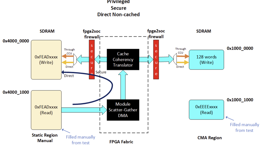

I think this is roughly equivalent to the Test 2 in this design post, having the following arch:
Which states that the CSR register must be set 0x3C108208 to achieve direct access for writing to SDRAM. However, since I did not include the ICCT module in my design, I ignored this for now.

Tried this with a connection to the altera ace5 cct and it worked well.
I suppose it is an issue with cache after-all!
