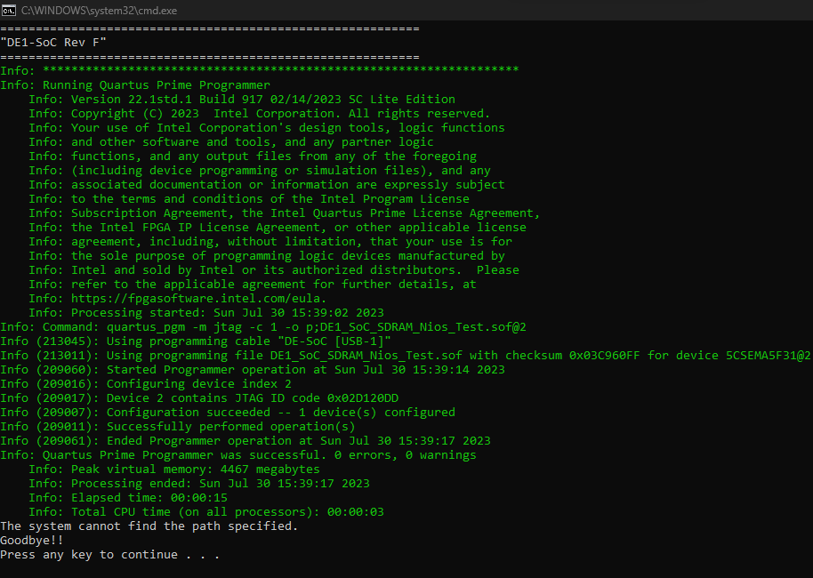

Whenever I try to execute batch file of ADC stored in the FPGA folder of Demonstrations, it gives me an error "The system cannot find the path specified". What should I do to make this work?

So my pc is running on windows.
I have quartus prime lite with 22.1 std version.
The project is given in DE1 SoC user manual in Examples for FPGA with the name of ADC reading.
I encounter the problem whenever I run the batch file and it says "system cannot find the path specified" and it fails to run NIOS II console window.

Actually got it working. I downgraded my quartus to 17.0 and it works perfectly fine. - mabdrahi

You need to open the makefile and check the directory set there, can you run any other designs?
This design from terasic which we will recommended to get help from there.
BUT
from our side we can provide best support. Try to run helloworld example with makefile.
