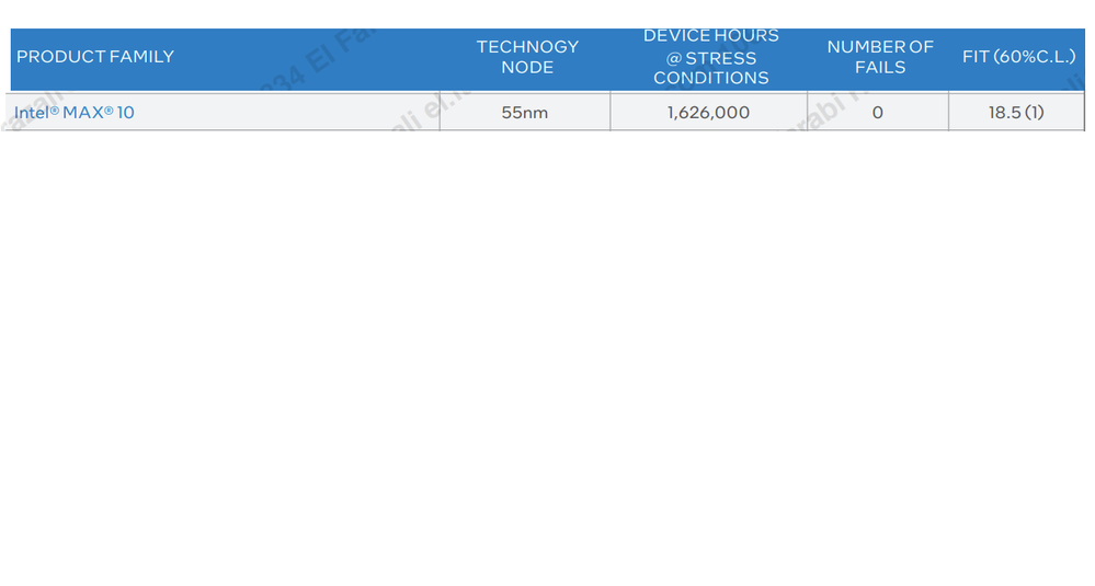

    MAX10 FIT rate below:

      Pooventhiran
      Could you provide the usage temperature, stress temperature and activation energy for above data.
      Also, how to derive FIT for other usage temperatures from it (the equation or standard for calculation).
