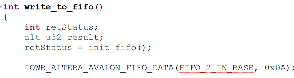

I am writing data into an Avalon-MM FIFO using Nios. Is it possible to read data from this FIFO inside the FPGA fabric using Verilog?

I am using the Avalon FIFO IP component to write data into from the Nios side.

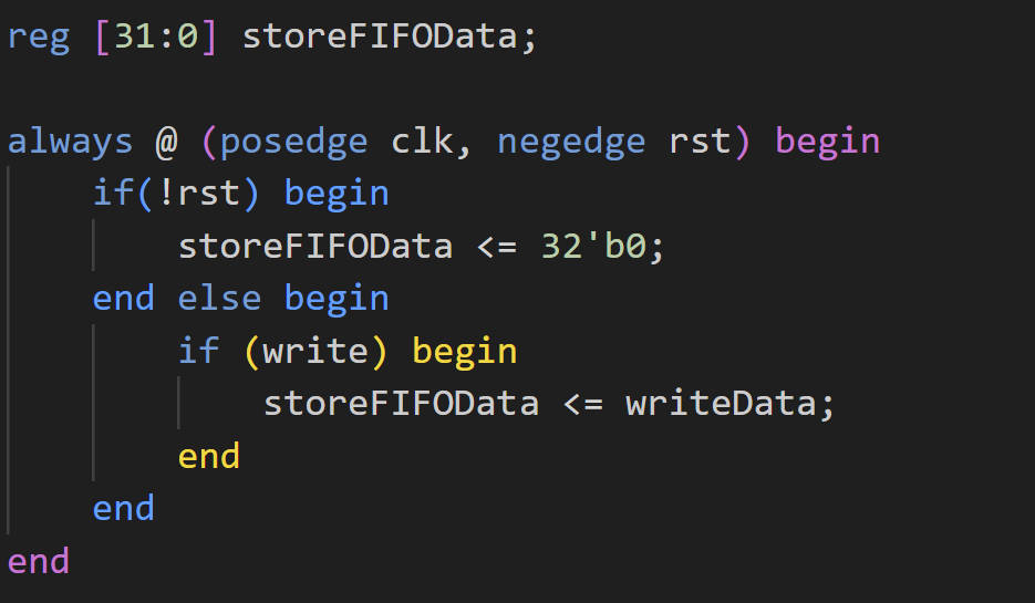

In order to read this data from the fabric, do I have to write a slave interface module (like a wrapper) and connect the signals to the FIFO instance?
Also, would a simple read-from-FIFO logic look something like this?

I want to read and store data on the FPGA fabric - hardware side. Is it possible to do so?
- sstrell
Yes, but you have to follow the Avalon standard: https://www.intel.com/content/www/us/en/docs/programmable/683091/22-3/memory-mapped-interfaces.html
- ShengN_altera
Why not you just use IORD_ALTERA_AVALON_FIFO_DATA to read the fifo data. Then use IOWR_ALTERA_AVALON_PIO_DATA to write data to PIO IP. Then read pio data in the Verilog (RTL) from pio ip instantiation?
